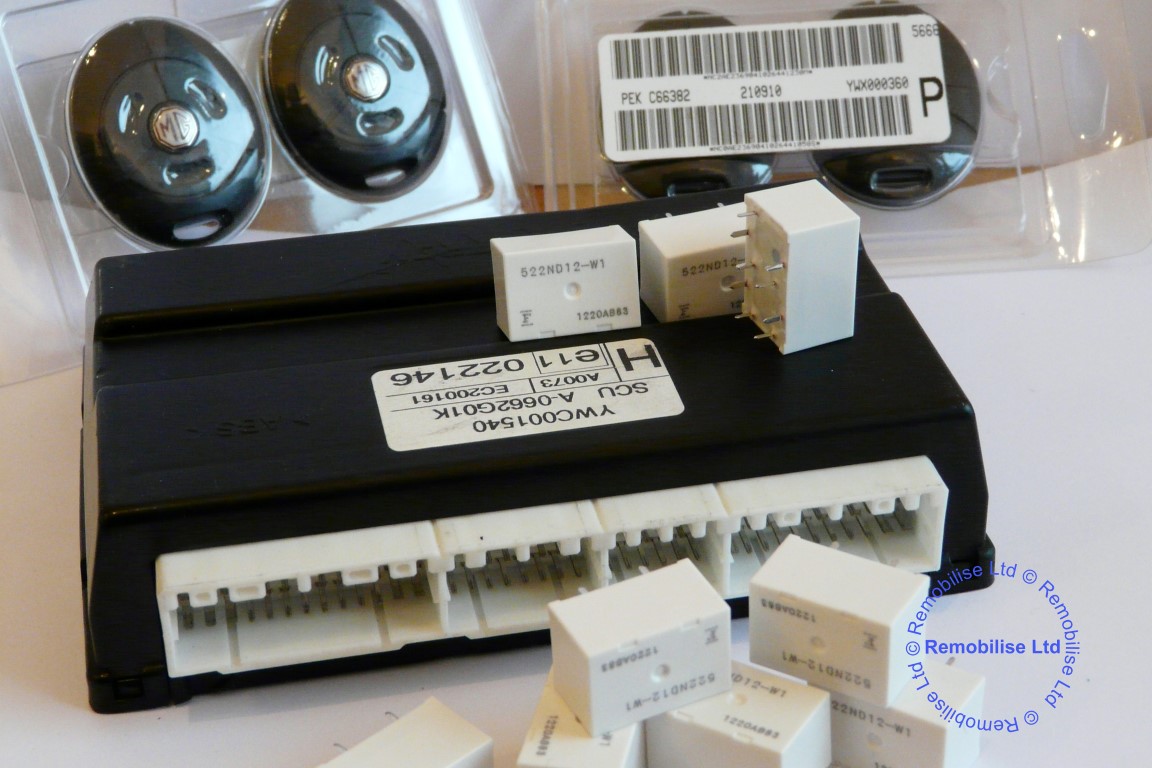

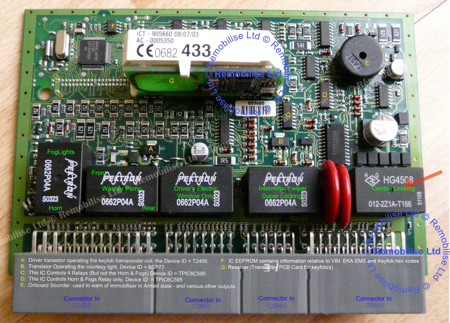

Hi
We can supply the relays and repair the Pektron SCU pcs's

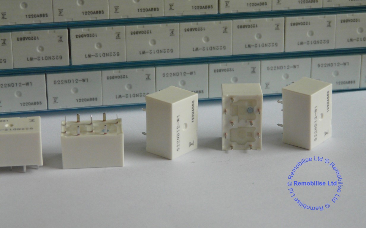

Supply or Fujitsu Relays (not obsolete - we have a large stock of FBR-522-ND12-W)
Supply of New Fobs
Refurbished boards Pektron SCU YWC001540 & YQWC001541
http://www.remobilise.co.uk
info@remobilise.co.uk
+44(0)1792896404
eBay
http://www.ebay.co.uk/sch/remobilise.ltd/m.html
Fujitsu Relays we Still can supply -same spec as the original Pektron SCU ones.
remobilize.co.uk1.jpg [ 154.32 KiB | 13364-mal betrachtet ]
Relays -Repairs -Fobs
remobilize.co.uk2.jpg [ 183.81 KiB | 13364-mal betrachtet ]

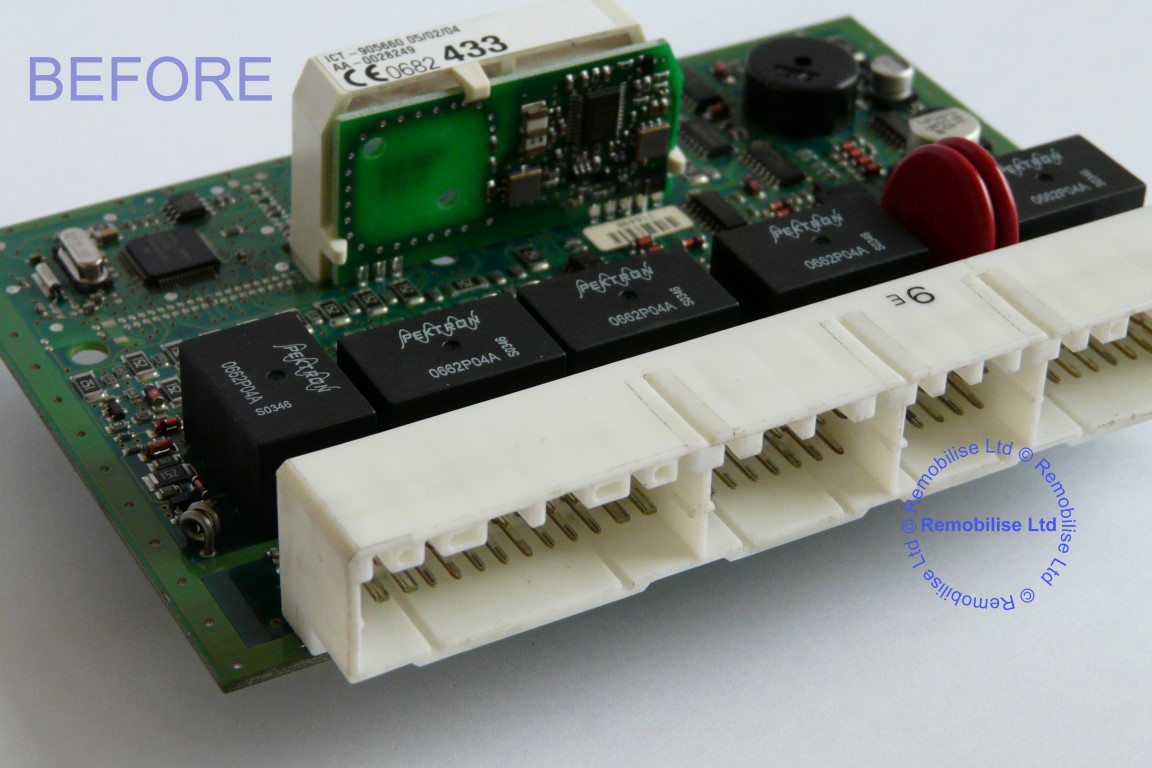

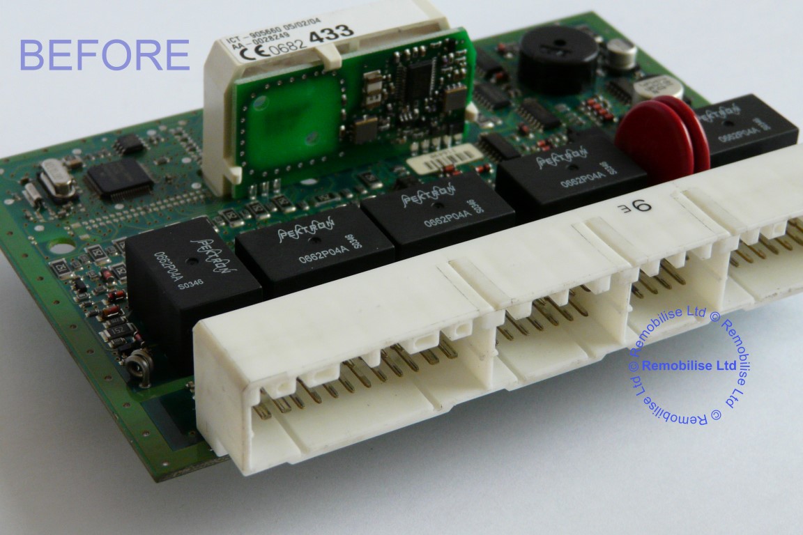

Old ones in Place BEFORE removal
remobilize.co.uk3.jpg [ 174.16 KiB | 13364-mal betrachtet ]

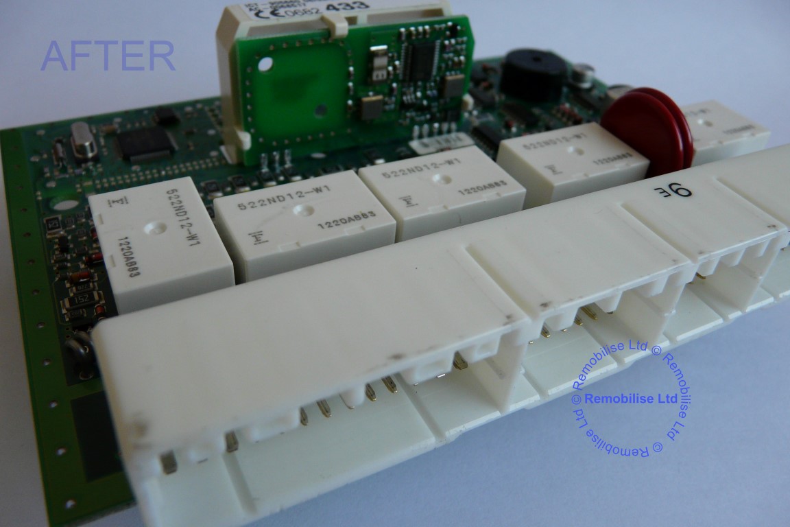

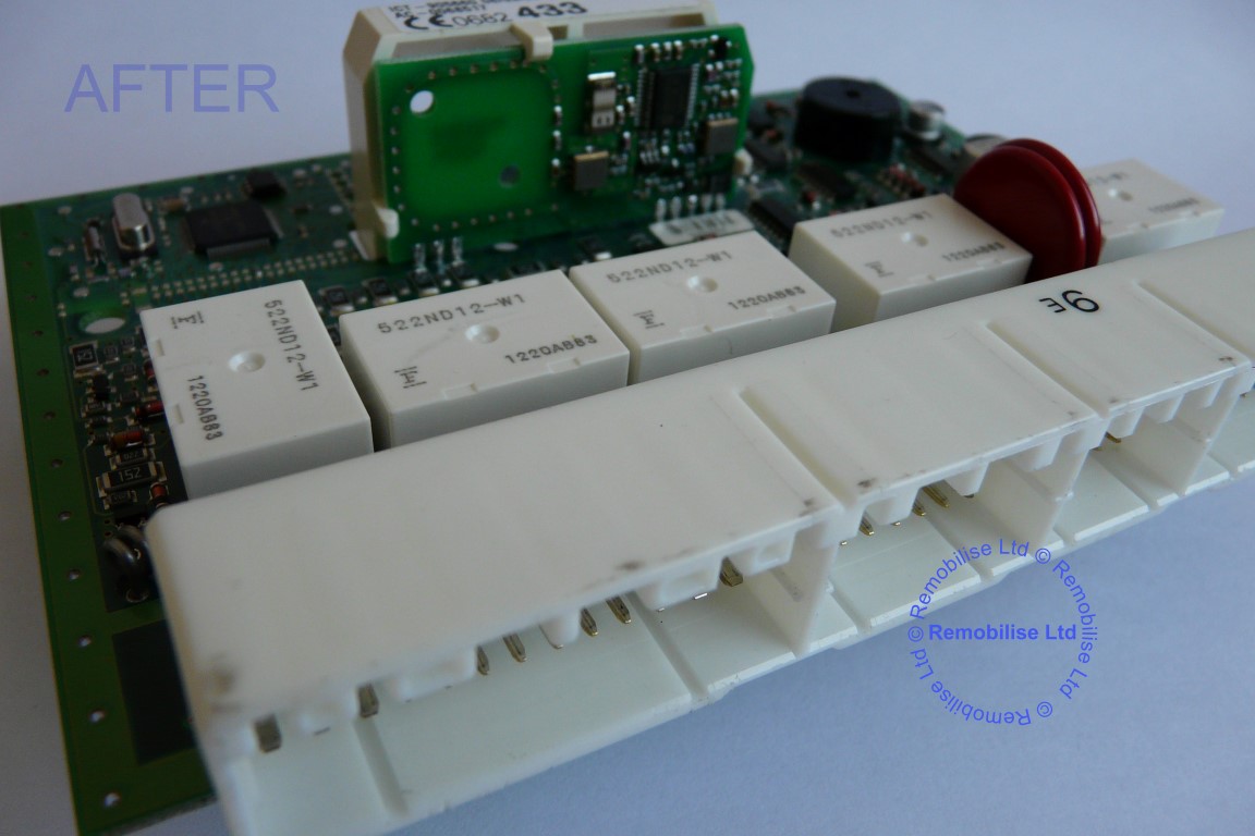

New Fujitsu FBR-522-ND12-W Relays in place
remobilize.co.uk4.jpg [ 138.2 KiB | 13364-mal betrachtet ]

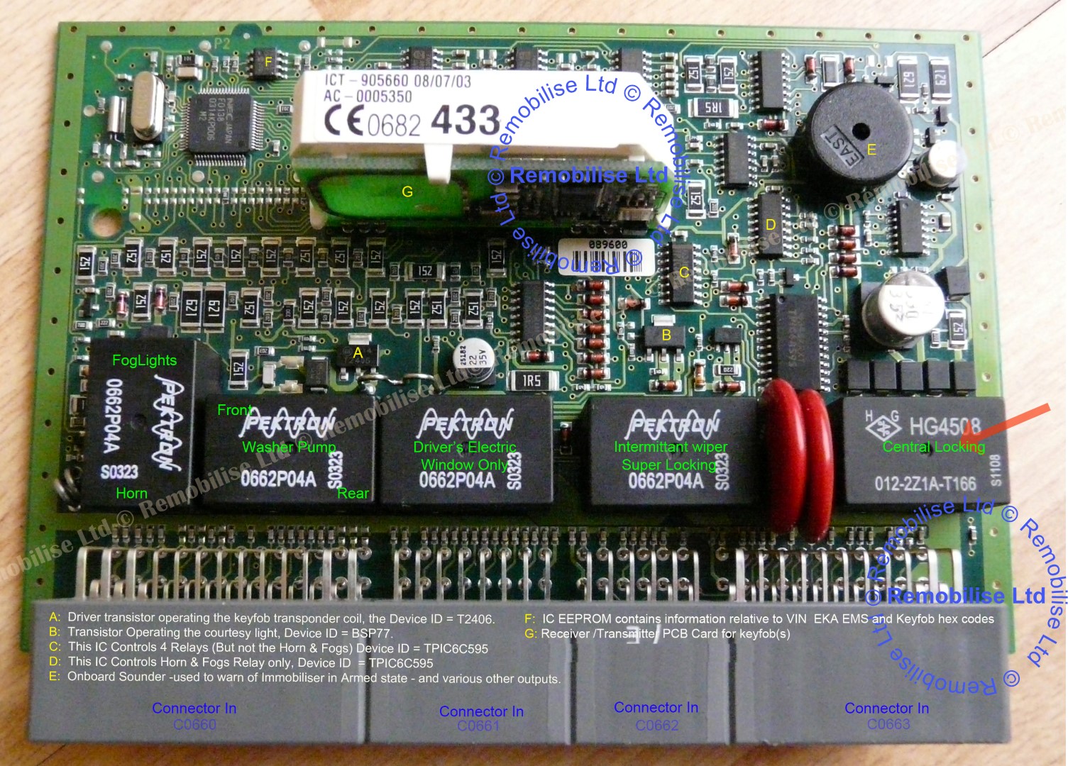

Identification of the Relays on the Pektron SCU
remobilize.co.uk5.jpg [ 539.64 KiB | 13364-mal betrachtet ]
IF YOU ARE EXPERIENCING ANY OF THE FOLLOWING
Central Locking - Locks but does not UNLOCK or unlocks but will not LOCK
Drivers Window - Goes up but not DOWN or down but not UP
Horn or Fogs - NOT working, or if the horn is Constantly ON
Windscreen Washers - Front or Rear NOT working
Intermittent Wipers - or Super Locking NOT working
DETAILS
These are all normally caused by Failed RELAYS in the PEKTRON Unit which can be replaced with the NEW RELAYS made by Fujitsu.
The Pektron Relays are mounted and soldered to a multilayer board via through holes.
Removing them via De-soldering and re-soldering the replacements can be difficult if you do not have any experience of this.
Overheating can loosen copper pads and damage other components.
We offer a replacement service via post for 1 - 5 Relays
I hope this is of some help...my daughter and husband and grandson live in Celle their German is a lot better than mine...I am sorry its not better.
Kev
Remobilise Ltd
Swansea UK
MG Rover Diagnostics and Programming - T4 Equipped -Repairs to Pektron SCU and 5AS units.
New 3Button Fobs
Relays and Repairs to the Pektron SCU
Clone/Synch Petron SCU / 5AS
Tel: +44(0)1792 896404

hab mir vor 3 Monaten einen TF gekauft, bei dem die Zentralverriegelung nicht mehr ging und mein Vorbesitzer hatte das Problem defekter Fensterheber, durch einen direkt angeschlossen Schalter mehr oder weniger elegant gelöst.
Mit dem Informationen die ich hier im Forum bekommen hatte, hab ich die Relais auf der Platine der BCU (schwarzes Kästchen hinter den Schaltern) durchgemessen und auch 2 defekte Relais entdeckt. Die Relais haben 2 Spulen für 2 Schaltbefehle. Die Spulen haben einen gemeinsamen Mittelabgriff. Die Anschlüsse liegen in einer Reihe auf der Rückseite und sollten etwa 180 Ohm haben.
Bei mir waren die Spulen durch. Die Relais habe ich, statt in England, bei einem Elektronikversand in Deutschland bekommen. Fujitsu Relais FBR512ND12-W1
3,90€ das Stück bei tn-electronics.de Sind halt mit weisem Gehäuse statt schwarz wie die orginall verbauten Printrelais.
Wer mit einem Lötkolben und einem Mulitmeter umgehen kann, für den sollte das Tauschen kein Problem sein.
Bei mir hat es einwandfrei funktioniert und somit einige hundert Teuros gespart.
