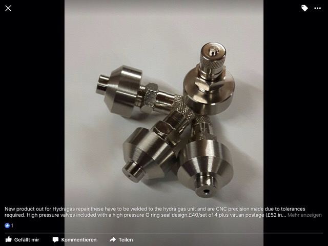

https://www.facebook.com/15022779851052 ... =3&theater
Photo von Mike Satur

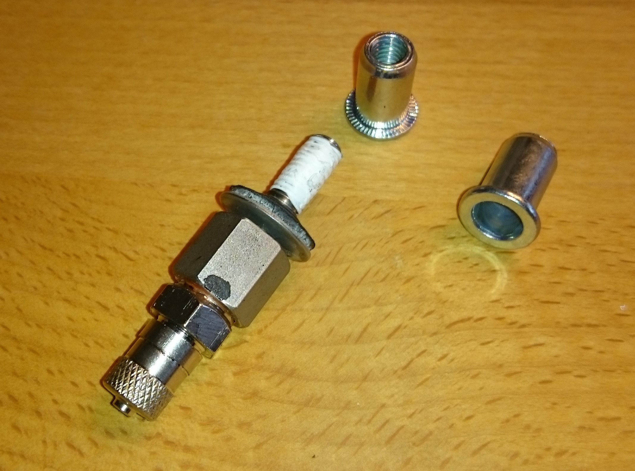

IMG_2260.jpg [ 77.84 KiB | 203064-mal betrachtet ]

MGF Hydragas re-gassing nipples now available. Prescision CNC manufactured in stainless steel to my design incorporating an internal viton O ring to seal the nipple into the adapter and a stainless steel domed washer with a neoprene seal bonded to the underside..The 'Schrader' valve is rated at 500psi so will cope with the 280 psi recommended nitrogen pressure easily.
These nipples are a DIY installation and do not require the time consuming and costly removal and replacement of the hydragas 'bottles' or spheres or welding (which can damage the internal rubber pocket) therefore allowing the owner to fit and have the nitrogen replenished at a local HVAC specialist that uses nitrogen to test for leaks in HVAC systems. This is a common test and is used by HVAC engineers everywhere..Once fitted the sphere can be re-pumped up temporarily with a normal air/tyre pump with sufficient pressure that will allow the car to be driven to a local HVAC centre or allow a site visit. It also allows the sphere to be tested to check if the diaphragm is ruptured. Simply fit and test with air and attach a tyre gauge to see if the pressure starts to drop. If it does then the sphere can be removed and a replacement also tested before fitting. The nipple can be removed by simply unscrewing and re-used on another sphere.Once fitted and recharged the cost saving over removing the 'bottles'/spheres and refitting can be as much as £350 plus any postage involved! The cost of these are £75 plus vat = £90 Royal Mail postage is £2.50 for UK purchases and approx £4-£8 .00 for other countries depending on location. I have made 25 car sets so it is a limited production run once gone it will be 3-4 weeks before we can remake more. If you have a MGF and want to restore the ride comfort then try these.

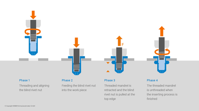

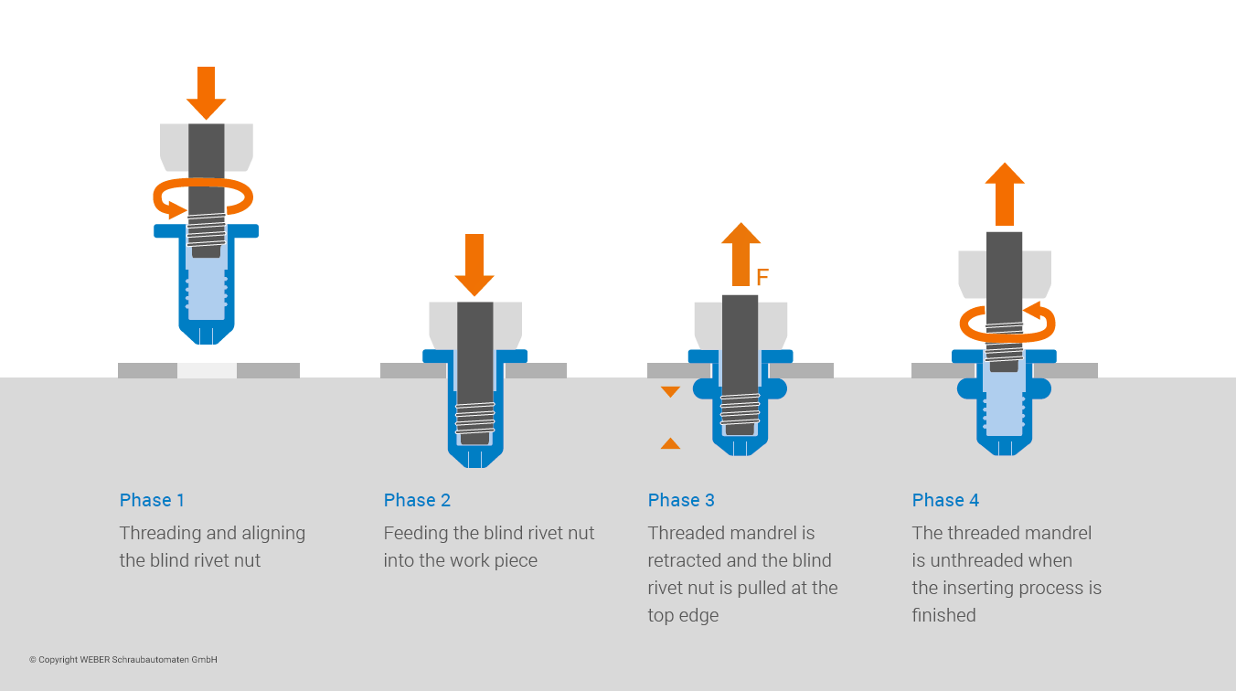

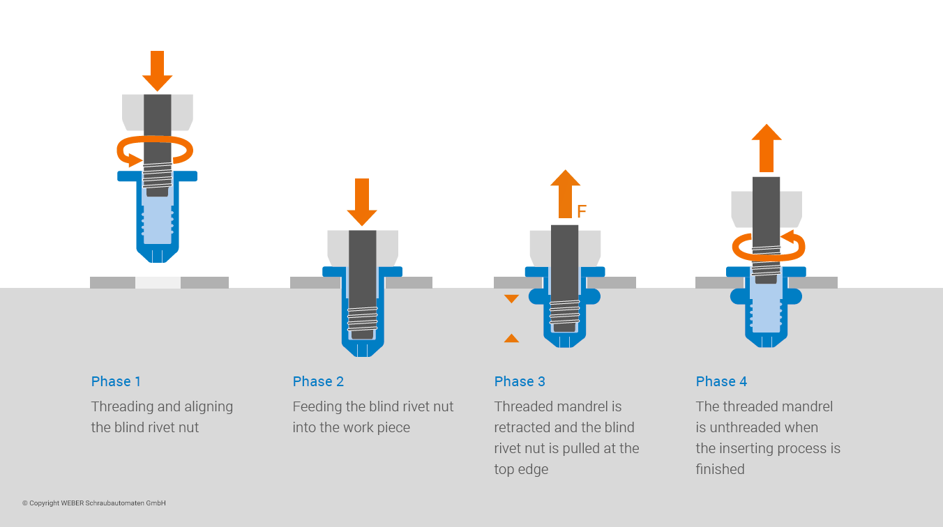

So wie ich das verstehe, wird eine Blindnietmutter verwendet, die in das zu bohrende Loch gepresst wird. Da wird dann ein Adapterstück (mit zusätzlichem vulkanisiertem Neopren-Dichtring) für das Schraderventil eingeschraubt.
Dateikommentar: Blindnietmutter
SBM_Prozess_EN_1352x756-1.png [ 39.06 KiB | 202997-mal betrachtet ]
Wenn das langfristig genauso dicht hält wie ein aufgeschweißtes Gewindestück, dann ist das ne geile Alternative.

So hab ich das verstanden:
- Blindnietmutter -> gasdicht verpresst (hoffentlich)
- dort eingeschraubtes Adapterstück -> mit vulkanisierter Dichtung
- wiederum dort dann das Schraderventil eingeschraubt -> O-Ring bezieht sich auf diese Verbindung

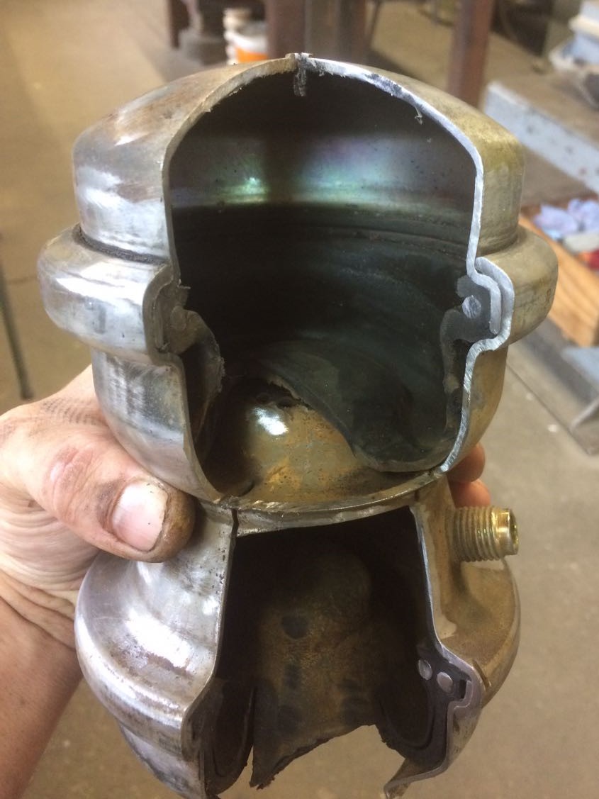

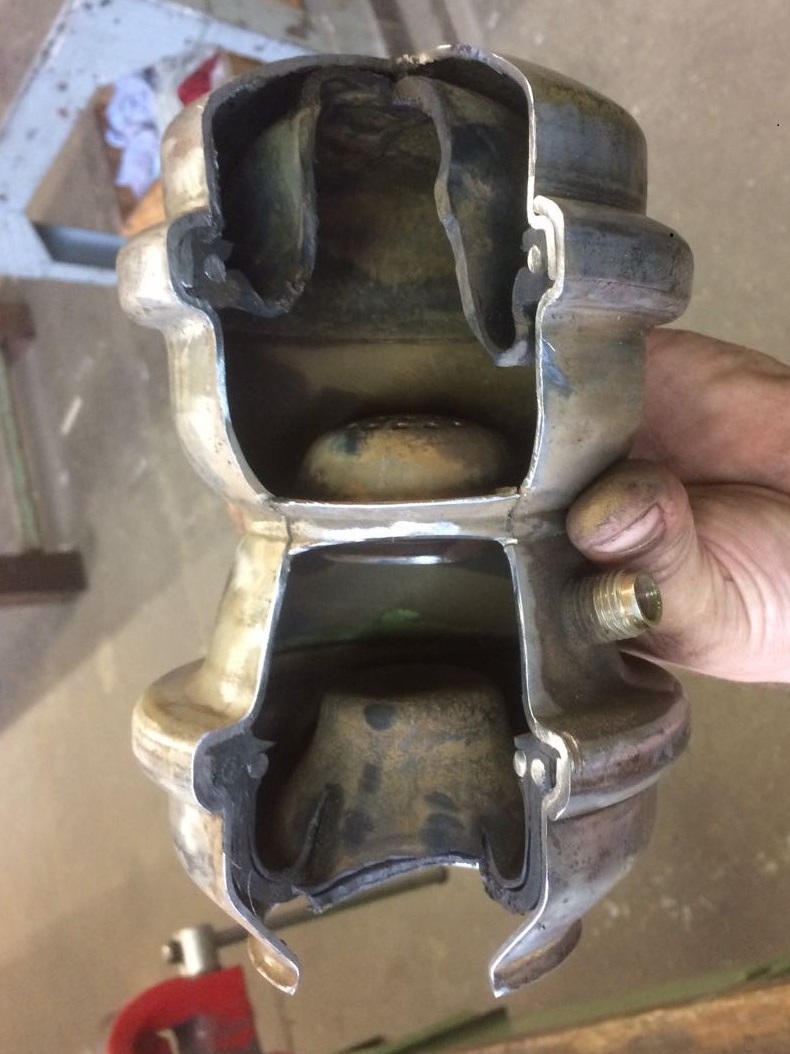

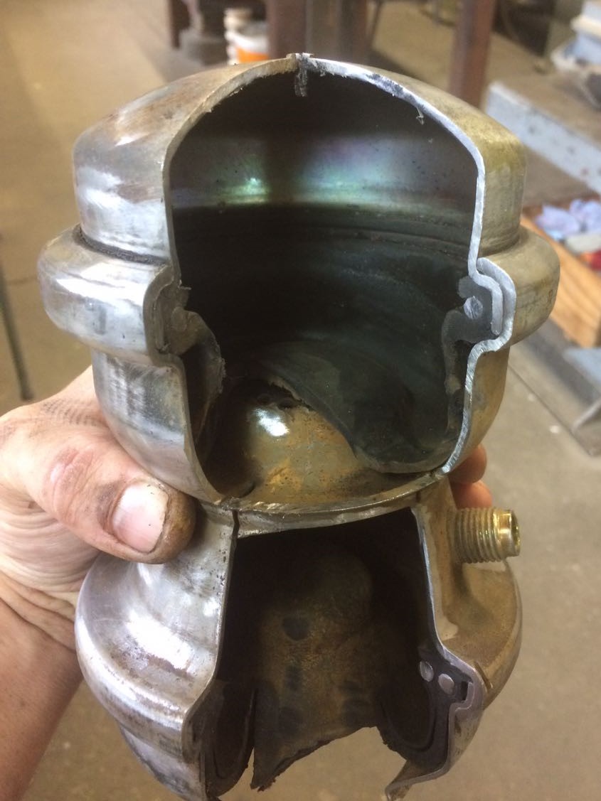

Unsern Markus hat mal eine Einheit auf seine Art mit der Flex anschaulich gemacht. So kann man mal abschätzen was beim Bohren oder Schweissen passieren kann :ugeek:
Da wird es am Besten gehen, wenn man vor dem Anbohren der oberen Dose vorab das System mit Vakuum beaufschlagt, damit das Gummiteil *sicher* unten sitzt und nicht angebohrt werden kann. Ich denke mal das Bohrspäne in dem Volumen unschädlich klein sein werden.
Danke mal für die Fotos an Markus :up:
Dateikommentar: So sieht eine Einheit aus wenn der Stickstoff so gut wie entschwunden ist.
Oben sieht man den Niet, der aber bei diesem dicken Gummi kaum was kaputt kriegen wird.
no_N2.jpg [ 190.34 KiB | 202358-mal betrachtet ]
Dateikommentar: Und hier das ganze wenn unten kein Fluid drin ist, aber das obere Volumen voll Stickstoff ist.
full_N2.jpg [ 150.84 KiB | 202358-mal betrachtet ]

Das könnte man dann doch im ausgebautem Zustand bei aufgebohrter Einheit (auf Stickstoffkammer Seite) beim Vakuum Pumpen Testen ? Wenn die Bohrung offen ist und man kein Vakuum ziehen kann ist die Membrane defekt ? Oder denke ich jetzt Falsch ?? Wenn Einheit oben aufgebohrt und Membrane ok müsste man ein Vakuum ziehen können ??

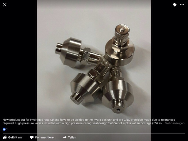

IMG_2434.jpg [ 48.94 KiB | 201387-mal betrachtet ]
....noch ne Alternative von Mike
Mod Edit: die schweißbare Version. Geht auch.

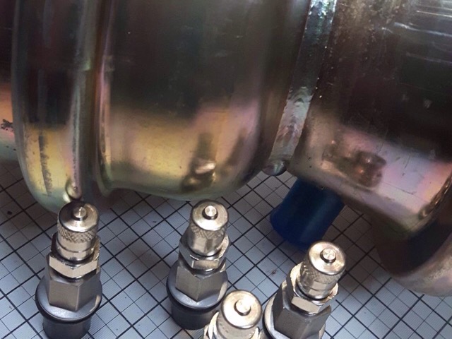

Mod Edit

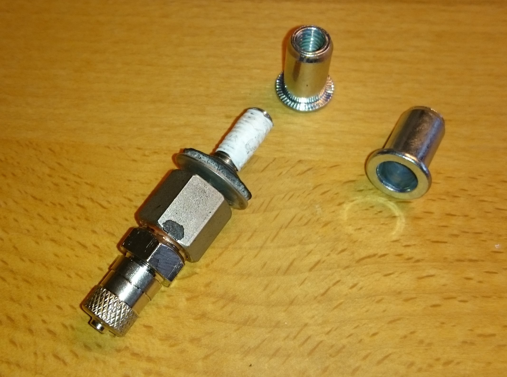

Dateikommentar: zwei hinzu, macht dann drei zum Umbauen
DSC_2249.JPG [ 992.54 KiB | 201576-mal betrachtet ]
Dateikommentar: Ventil und Niet
DSC_2209 (2).JPG [ 636.27 KiB | 201576-mal betrachtet ]

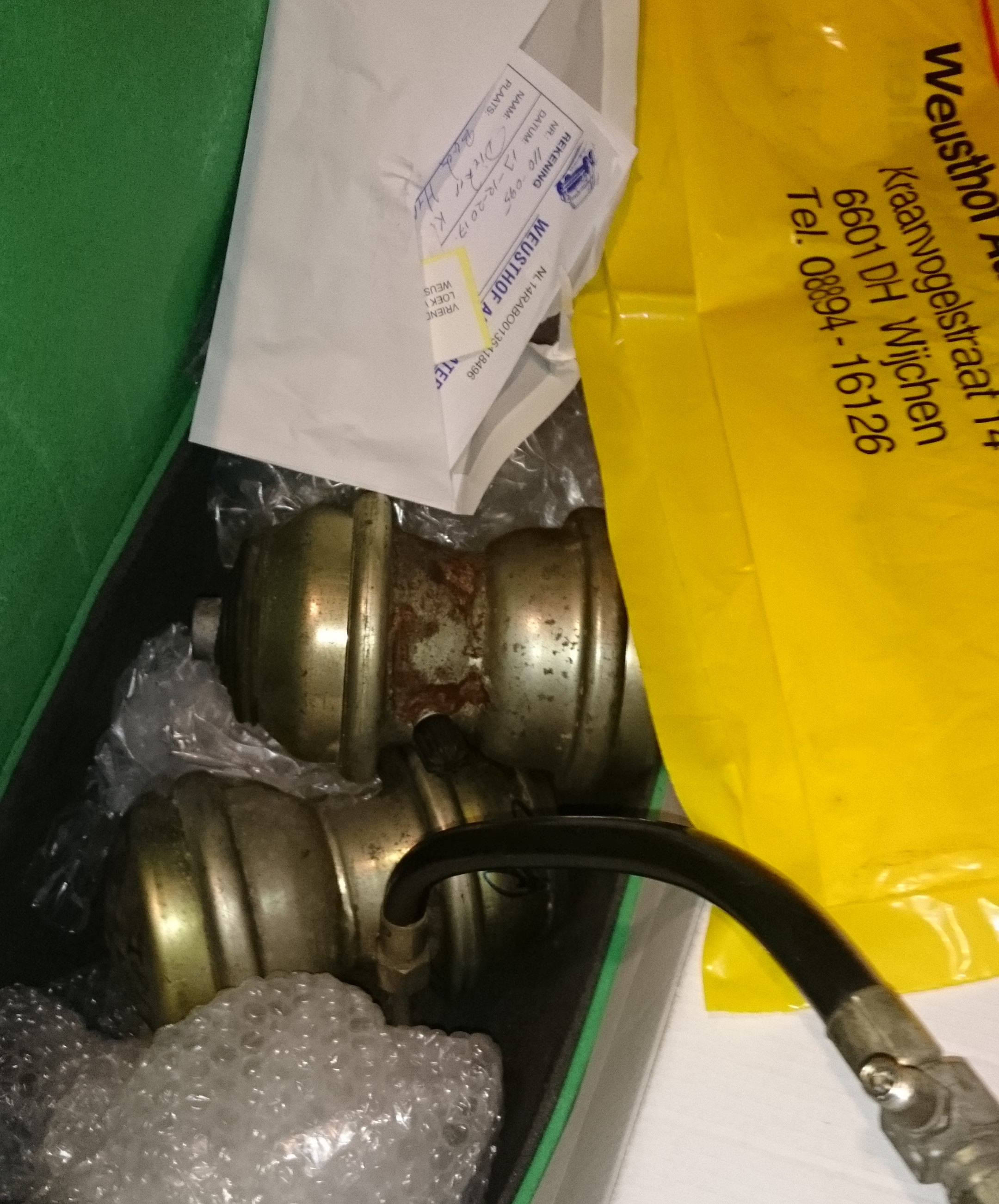

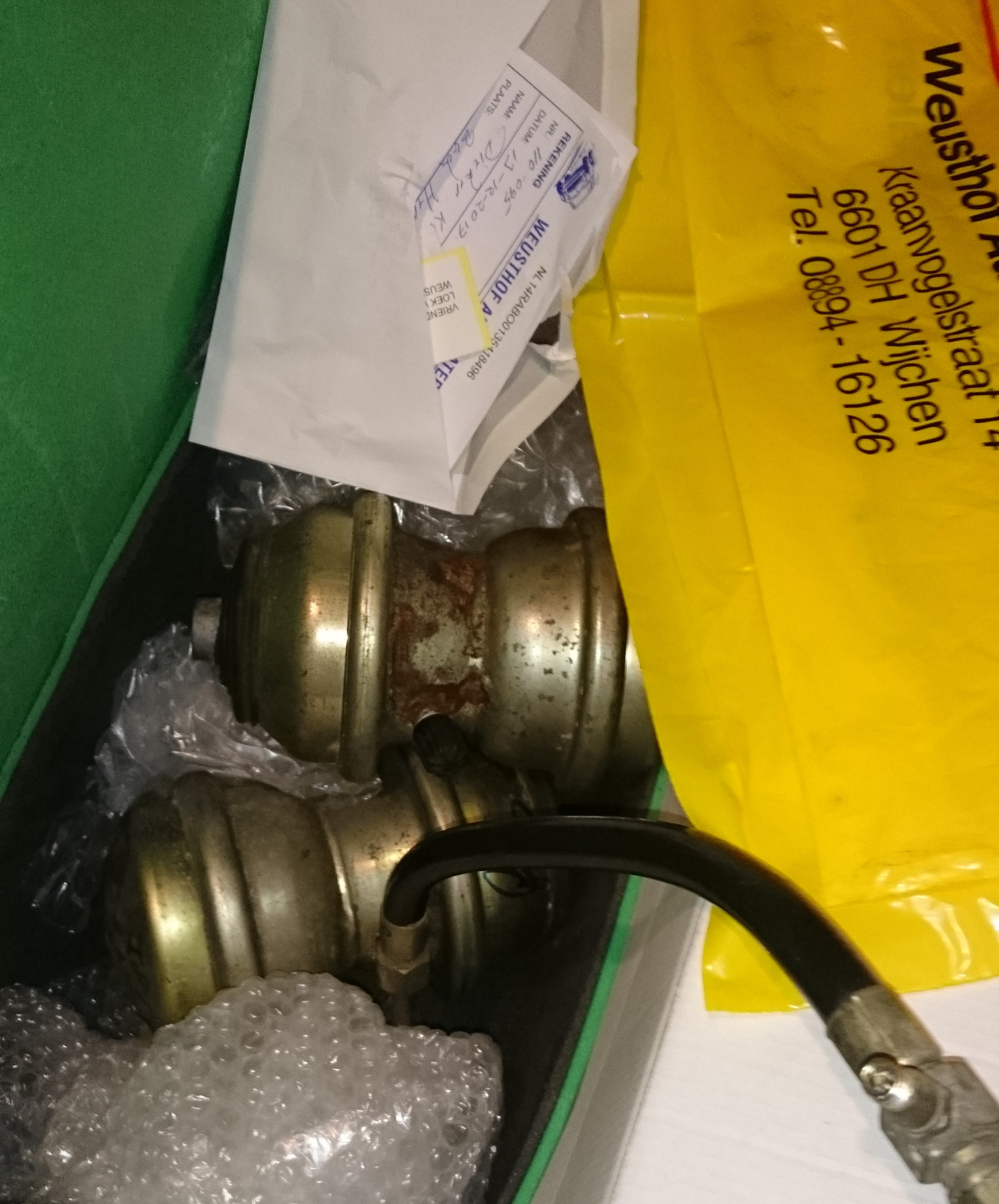

Aus Holland gibt es jetzt die Hydragaseinheiten "refurbished".
Neu befüllt. Sieht anders aus als die Fotos von Dieter.
Bekomme den Link übers Handy leider nicht hier rein kopiert aber CowaCarparts aus EBay Kleinanzeigen kennt ihr sicherlich
