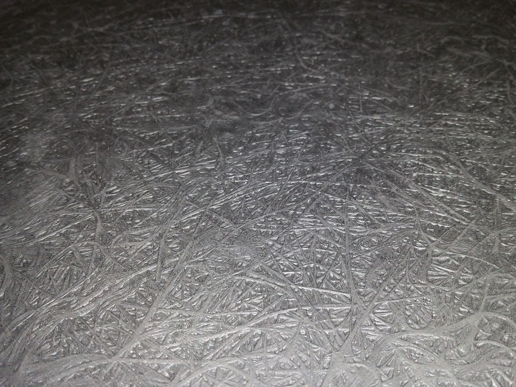

I just want to share some impressions of the box:

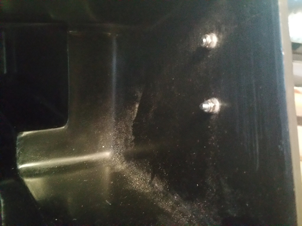

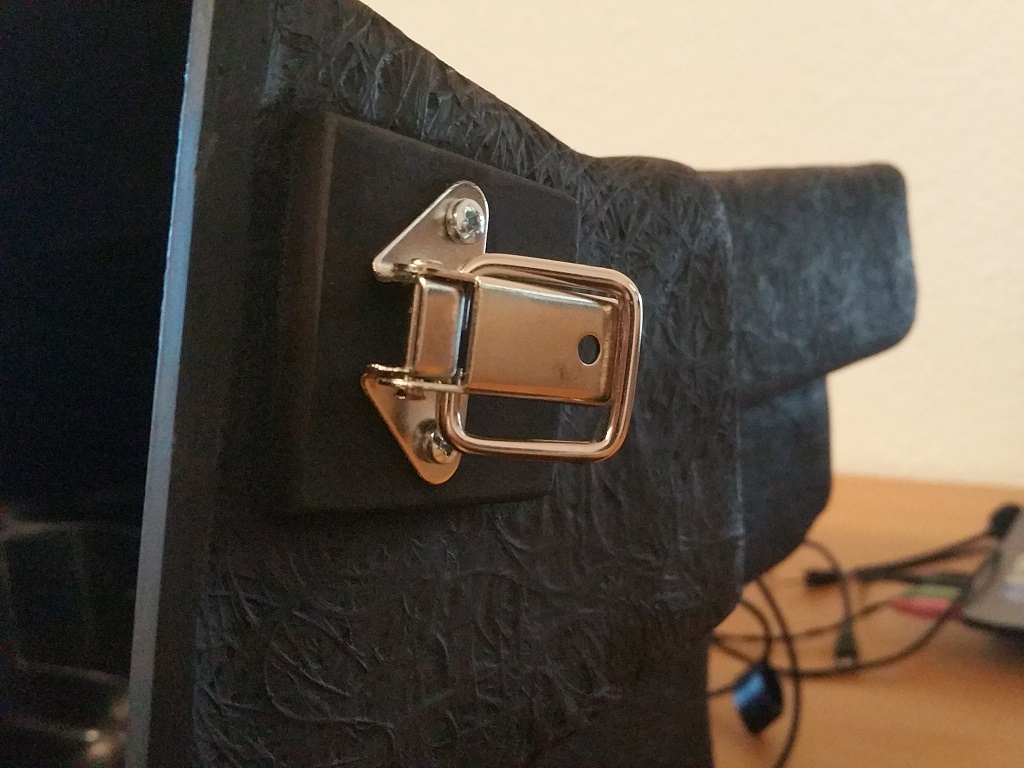

20170627_212015.jpg [ 155.03 KiB | 105696-mal betrachtet ]
20170627_212158.jpg [ 379.58 KiB | 105696-mal betrachtet ]
20170627_211931.jpg [ 184.63 KiB | 105696-mal betrachtet ]
20170627_211940.jpg [ 230.33 KiB | 105696-mal betrachtet ]

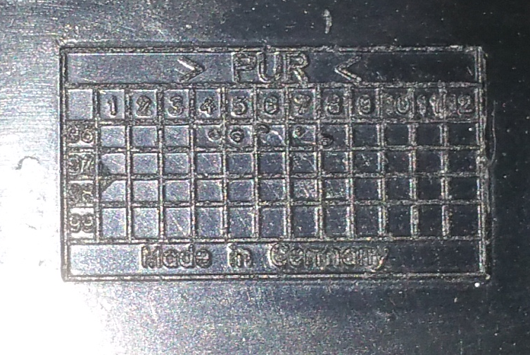

It seems so the part is made out of the Material "PUR" with a tool from April - August 1996.
Label.png [ 872.96 KiB | 105696-mal betrachtet ]
:shock:
no, production date August 1996, adding on dot more, September, and another dot, October, .....
Mi 28. Jun 2017, 00:12
Beiträge: 1218
Beitrag Re: Frontbox and a/c
Well, I think my sentence and questions are still correct. ;)
My box was produced with a tool from August 1996,you are right. But I wrote "with a tool from April - August 1996".
So the tool was used for 5 months and is 21 years old. This was my message. I care more about the question of tooling then the part, because I wonder how Cowacarparts Supplier can reproduce this boxes.
First I thought this is a some kind of reconstruction, now we know someone has the old tools and reproduce these boxes to OEM Spec. Similarity is quite safe.

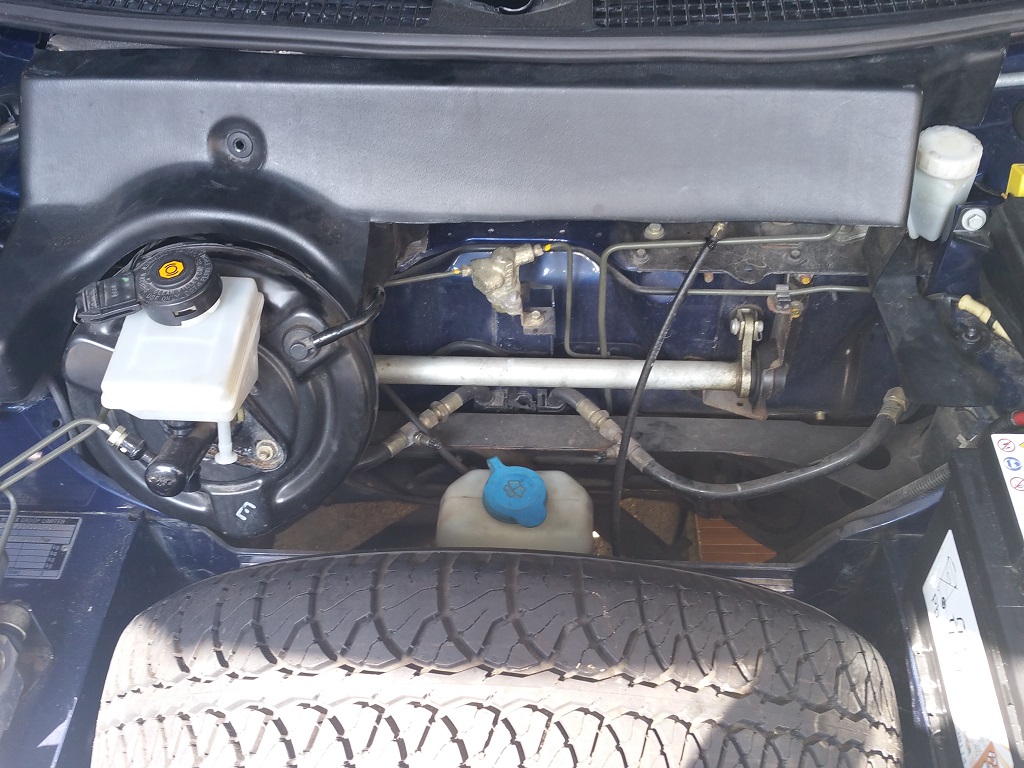

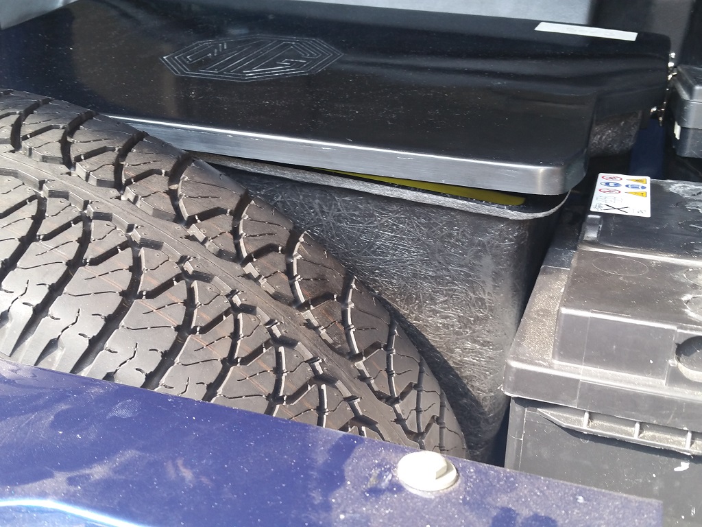

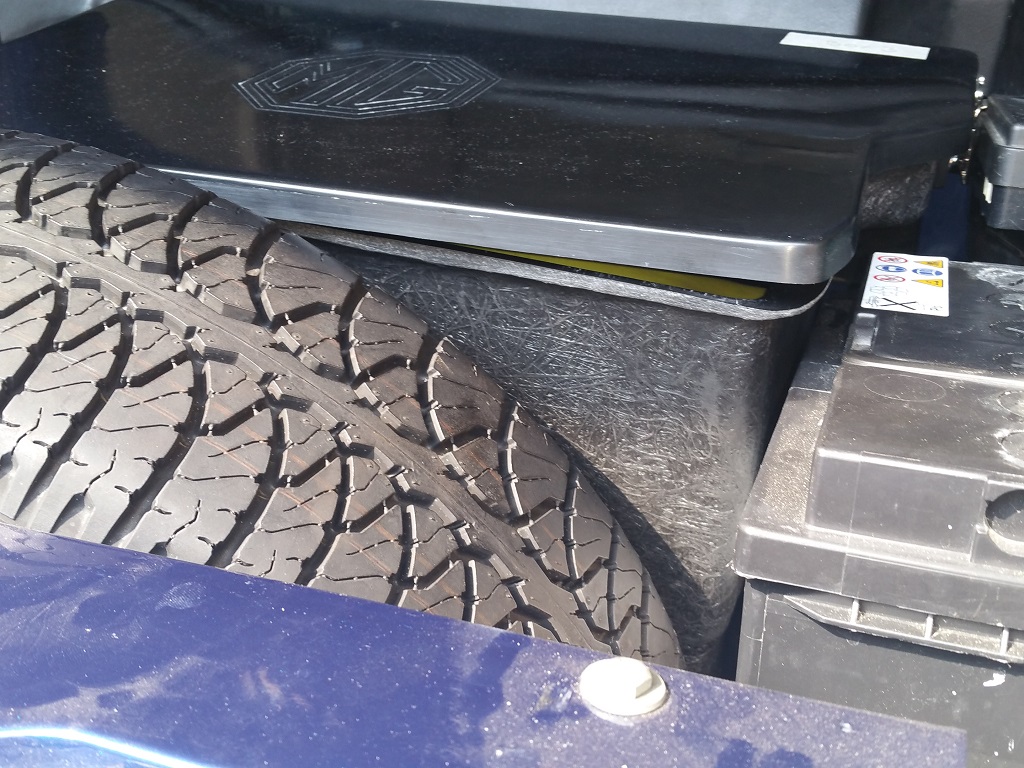

I fitted the box today.
First cut of the front trim I tried according to the OEM installation manual:
20170708_162811.jpg [ 271.94 KiB | 105384-mal betrachtet ]
And for the first try very good, it fits.

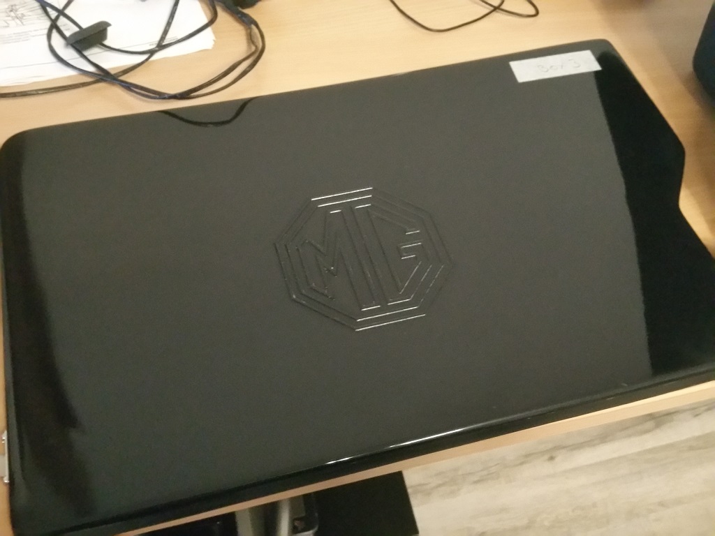

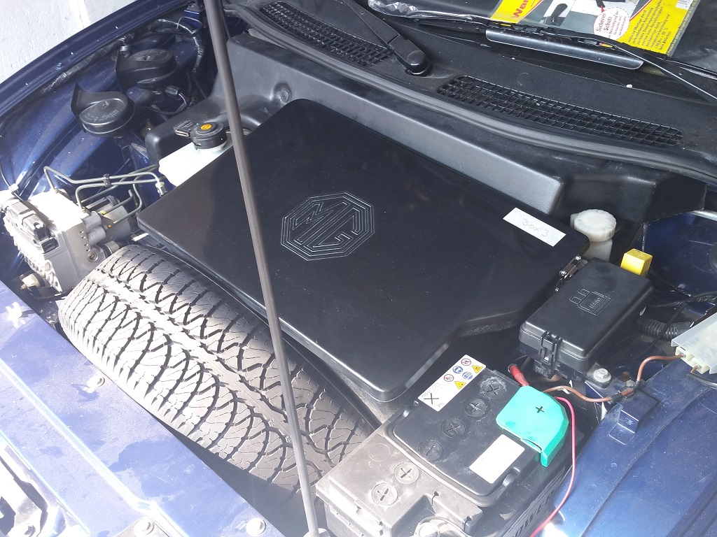

20170708_163833.jpg [ 315.5 KiB | 105384-mal betrachtet ]
But its seems to be not very even. Battery side sits a bit lower. Due to that fact of poor build quality or heavy loading there is a gap:
20170708_163842.jpg [ 305.58 KiB | 105384-mal betrachtet ]
Sa 8. Jul 2017, 18:52
Check the lower seam where the box should rest in the spare wheel space.
The seam of the box should go behind the metal part... direction cabin.
Is it ?
