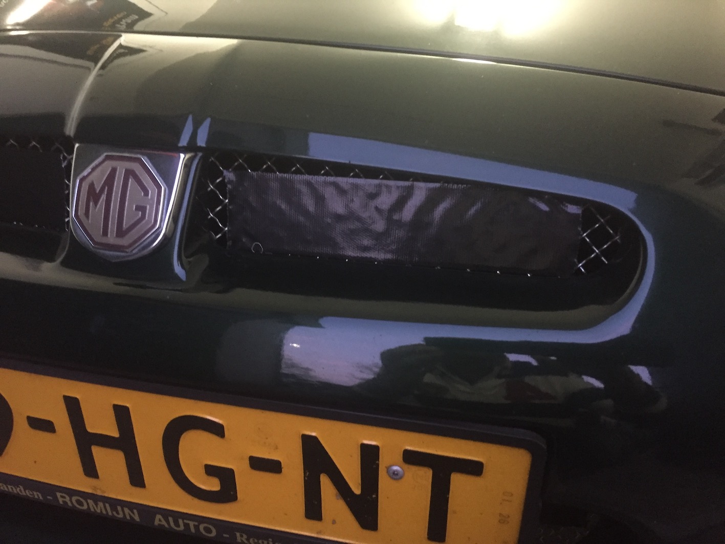

Since 3 weeks I am the proud owner of a 2001 MGF. Driving it I noticed that the coolant temperature stays low to very low , behaves erratic all the time, and it takes a very long time before the coolant/oil temperature reaches a 'normal' level compared to all my other cars, if ever!
Ambient temperatures are low at the moment, in the region of 1 to 7 degrees C.
Two days ago I decided to 'duct-tape' all air intakes at the front of the car more or less shut and 'surprise-surprise' coolant temperature reaches the normal level (one notch below the middle) in about 5 minutes en oil reaches a 100 degrees in about 10 minutes. Both 'rock steady'...
One of the main reasons for head gasket failure is thermoshock because of the amount of cold water from the radiator and the position of the thermostat. IMHO this steady temperature AFTER duct-taping the inlet decreases the thermoshock risk, doesn't it?
Is there something wrong with my reasoning? Is there anybody on this forum with experience with taping off the mesh inlets? (I can't think of anything against this procedure because oil and coolant temperatures are normal now and steady....)
I am curious what other forum members think about this...

Hi Alex,
from your description I would say that either the thermostat is stuck open or a previous owner has removed it to “improve” cooling. Had the former on my TF when I bought it and the latter on a friend’s car this year.
With the TF having a PRT fitted, putting a new ’stat in was quite easy, on an “old school” vehicle this is a bit challenging. On my friend’s car (as I know there was no thermostat fitted) I swapped the hoses for the PRT setup (story here).
Duct taping will of course hinder the air flow through the radiator but might lead to problems in slow moving traffic. So you should rather find the roots of the issue and get it fixed properly.

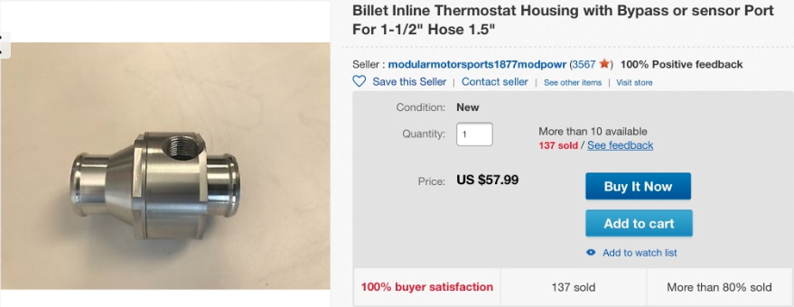

Yesterday I finished the head gasket replacement and all looks well! No leaks, no hiccups, and a normal operating temperature. I came to the conclusion that in its former life someone removed the thermostat without altering the cooling system, so that has been the reason for the erratic behavior of the engine temperature. This is what the new thermostat & bypass looks like:

@Alex. Well done, this thermostat will be my next Project. Btw, the fittings are selfmade or buyable products?

Hi Sepp, I found this thermostat housing on e-bay (USA). Search for "billet inline Thermostat Housing" and you will find one for 50,73 euro's with a 'bypass or sensorport'. They make them in badges, but there are still a couple left. I had to change the thread for the 'schlauchstutzen' from 1/2" NPT (can't get that anywhere in The Netherlands) to 1/2" BSP, but that was easy. In it I used a Gates thermostat of 82 degrees Celsius as in most Lotus Elises and it works like a charm. Watertemperature is at a normal level in about 4 kilometers normal driving and oil temperature in about 8 to 10 kilometer (80 degrees). Watertemp. is very stable at one notch below the halfway mark; oil never goes higher than 100 degrees with the actual ambient temperatures and fast driving.
All in all I am very satisfied with the way things turned out to be! I changed the head gasket, plugs, timing belt, oil rail, SS-cooling pipes, etc. I painted the subframes, cleaned out the wheel arches and applied a fresh coat of 'bodyschutz' to the underside of the car and changed the tires to Vredestein Sportac 5's so it should be serving me well for the years to come!!!
